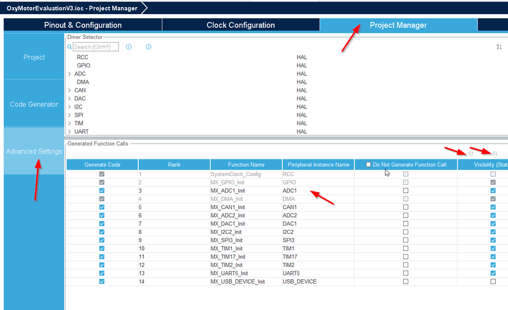

2022-07-06 5:15 AM
The problem still exists with CubeIDE V1.9.0 on STM32L4 V1.17.2
New aspect: I normally can modify the order of initializaiton in IOC file in "Project Manager" / "Advanced settings"
One can see, that some lines are "fixed" and cannot be modified like "clock" "GPIO" and "DMA".
The Line ADC1 cannot be moved either. For some reason, ADC1 is not allowed to be moved. Others can be moved.
It is possible to edit this sequence though, by editing the IOC-File "by hand".
ProjectManager.functionlistsort=1-SystemClock_Config-RCC-false-HAL-false,2-MX_GPIO_Init-GPIO-false-HAL-true,3-MX_DMA_Init-DMA-false-HAL-true,4-MX_ADC1_Init-ADC1-false-HAL-true,5-MX_CAN1_Init-CAN1-false-HAL-true,6-MX_DAC1_Init-DAC1-false-HAL-true,7-MX_I2C2_Init-I2C2-false-HAL-true,8-MX_ADC2_Init-ADC2-false-HAL-true,9-MX_SPI3_Init-SPI3-false-HAL-true,10-MX_TIM1_Init-TIM1-false-HAL-true,11-MX_TIM17_Init-TIM17-false-HAL-true,12-MX_TIM2_Init-TIM2-false-HAL-true,13-MX_UART5_Init-UART5-false-HAL-true,14-MX_USB_DEVICE_Init-USB_DEVICE-false-HAL-falseNow it is correct

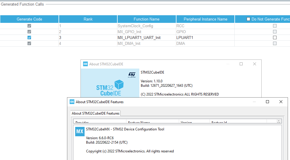

2022-07-07 2:59 AM
Hello @victagayun ,
Did you by any chance migrated your project to v1.10.0 with the wrong order or did you start a new project with the latest version?
Sara.
2022-07-10 10:59 PM
was able to reproduce this situation in both scenarios - migration AND new project creation.
@Johannes 's workaround and his manual editing was the same I did and for now it works. But the original Problem still exists, you have to check manually, if the order is correct.
