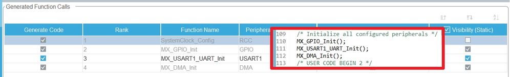

Wrong initialization order on STM32H7B0VBT6 latest STM32CubeIDE and firmware.
Can't change initialization order in advanced settings, arrow buttons are grayed out:
IOC file attached
current solution is to manually edit ProjectManager.functionlistsort line of IOC file;
before:
ProjectManager.functionlistsort=1-SystemClock_Config-RCC-false-HAL-false,2-MX_GPIO_Init-GPIO-false-HAL-true,3-MX_USART1_UART_Init-USART1-false-HAL-true,4-MX_DMA_Init-DMA-false-HAL-true,0-MX_CORTEX_M7_Init-CORTEX_M7-false-HAL-true
after:
ProjectManager.functionlistsort=1-SystemClock_Config-RCC-false-HAL-false,2-MX_GPIO_Init-GPIO-false-HAL-true,3-MX_DMA_Init-DMA-false-HAL-true,4-MX_USART1_UART_Init-USART1-false-HAL-true,0-MX_CORTEX_M7_Init-CORTEX_M7-false-HAL-true

2022-10-26 12:36 PM
Test with STM32CubeIDE v1.10.1 containing STM32CubeMX STMicroelectronics 6.6.1.202207061420, creating project for NUCLEO-H7232ZG to use DMA to move data from memory to USART3.
Initialization order created by program does not work because code called by MX_USART3_UART_Init attempts to change DMA1 peripheral registers before DMA1 has been enabled in RCC.
Initialization order created by STM32CubeMX:
SystemClock_Config();
/* USER CODE BEGIN SysInit */
/* USER CODE END SysInit */
MX_GPIO_Init();
MX_ETH_Init();
MX_USART3_UART_Init();
MX_DMA_Init();
MX_USB_OTG_HS_USB_Init();
/* USER CODE BEGIN 2 */
In Project Manager - Advanced Settings - Generated Function Calls, the engry for MX_DMA_Init() is greyed out and cannot be moved, butthe MX_USART3_UART_Init() entry can be shifted down to correct the error.
