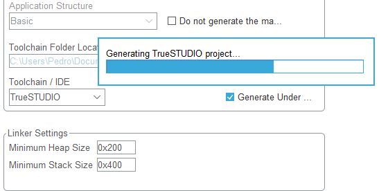

2020-03-21 12:32 PM
Hi @Khouloud ZEMMELI ! I'm having the same problem. I'm using Win 10 (64bit) and Java_Runtime_Environment_(64bit)_v8_Update_45. I can't undersatnd why cubemx is stucking while copying files for code generation. Can you please help me understand how to solve it ?
