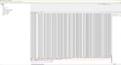

I've been trying to build example projects (i.e. Ux_Host_HID) with the make tool chain config with stm32cubeMX
So when i run make, a bunch of stuff compiles, then i get this error.

I think the reason why this is failing, is because there are 3 versions of these assembly files
/home/williamkolment/STM32Cube/Example/Ux_Host_HID/Middlewares/ST/threadx/ports/cortex_m7/gnu/src/
/home/williamkolment/STM32Cube/Example/Ux_Host_HID/Middlewares/ST/threadx/ports/cortex_m7/ac6/src/
/home/williamkolment/STM32Cube/Example/Ux_Host_HID/Middlewares/ST/threadx/ports/cortex_m7/iar/src/
one for each type of toolchain. So, I suspect the vpath directive(lowercase) is not working properly
i.e. these lines -> vpath %.s $(sort $(dir $(ASM_SOURCES)))
So instead, I appended a path to VPATH make shell variable each time theres duplicate sets of files
VPATH = Middlewares/ST/threadx/ports/cortex_m7/gnu/src
This FIXED THE COMPILATION ERRORS
I suspect, that STM32CubeMx is generating more files a than needed.
