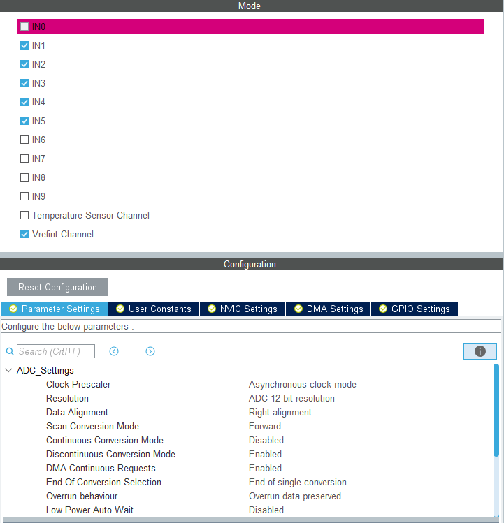

I have problem with configuration ADC (6 regular channel) and DMA. CubeMX generate next code:

My Cube version 5.1.0 (downloaded at march 21 2019)
Configuration in Cube:
