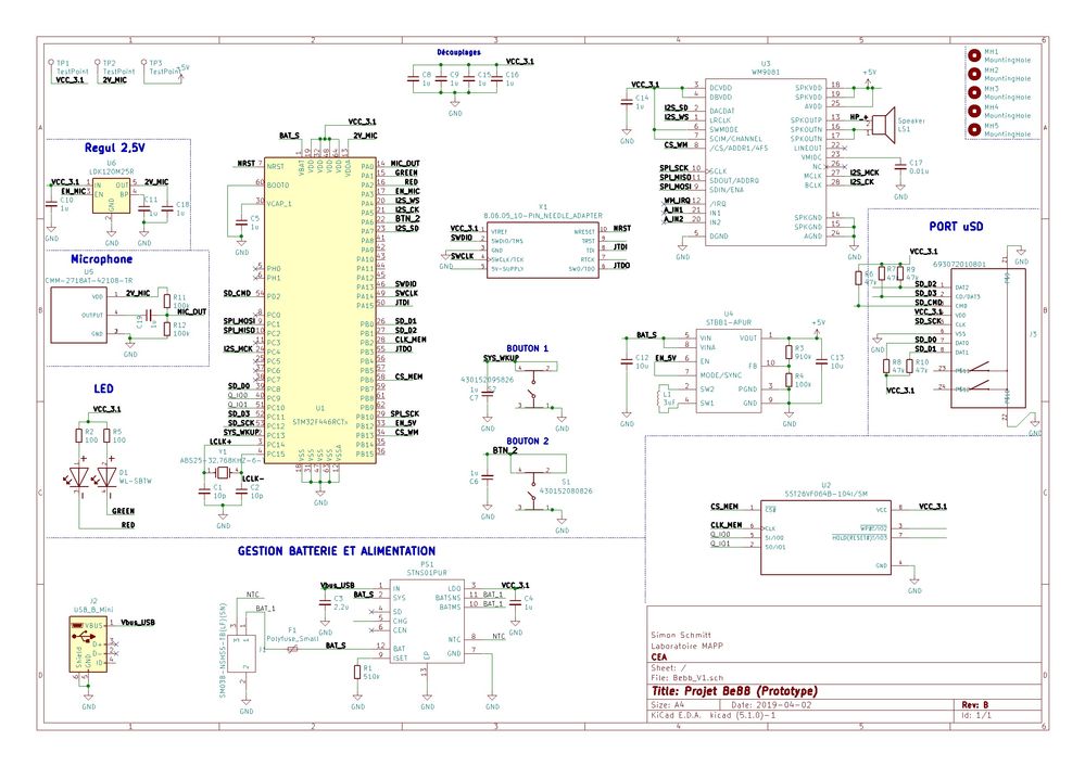

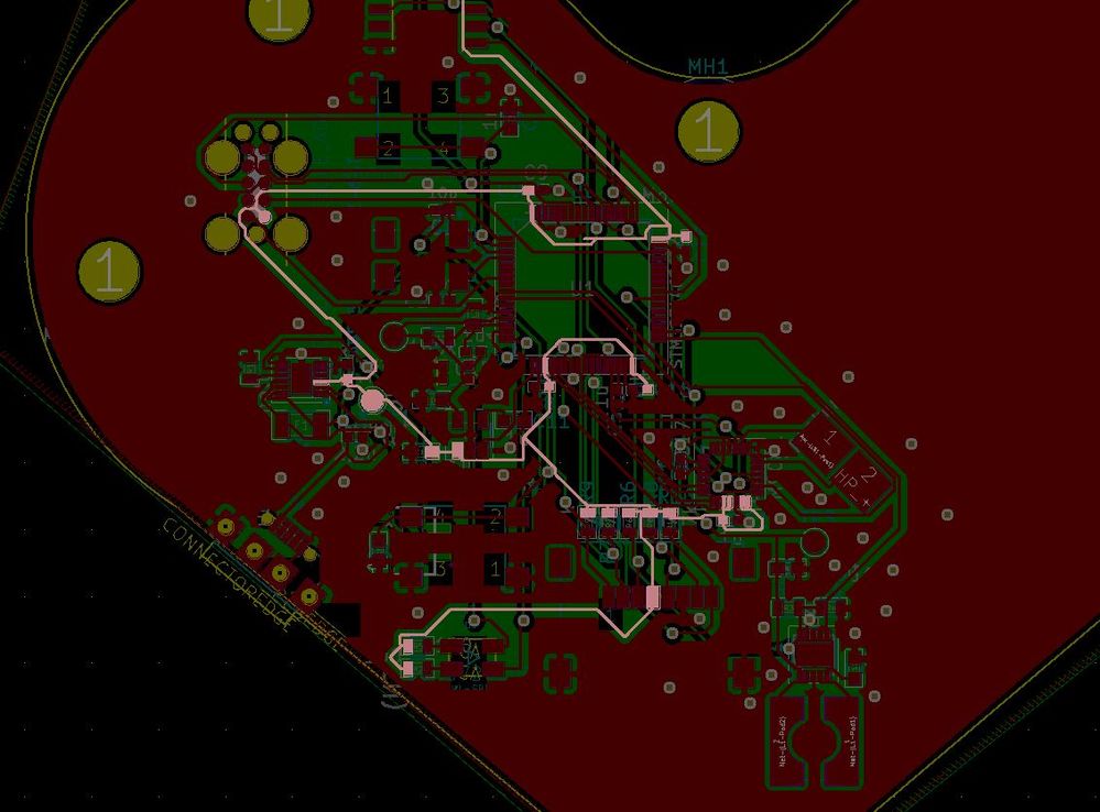

2019-05-21 12:57 AM
I'm back here due to the same kind of problem...
I've assembled my design with a new board (I corrected some mistakes which don't imply the uC) and now, the J-link can't even find the uC.
Here is the design:
and here is the board:
What you see highlighted is the LDO 3.1V line from an STNS.
What I checked on my board with an oscilloscope is that JTDO is the only signal which don't seem to be properly driven. The signal is very noisy and I can perceive that it try to answer but the noisy signal just have a slightly higher average.
I tried to connect the Needle 10 pins to an ST-link and it don't work either.
If you have an idea...
Thank you.
2019-05-21 2:15 AM
Well, You should read AN4488...
