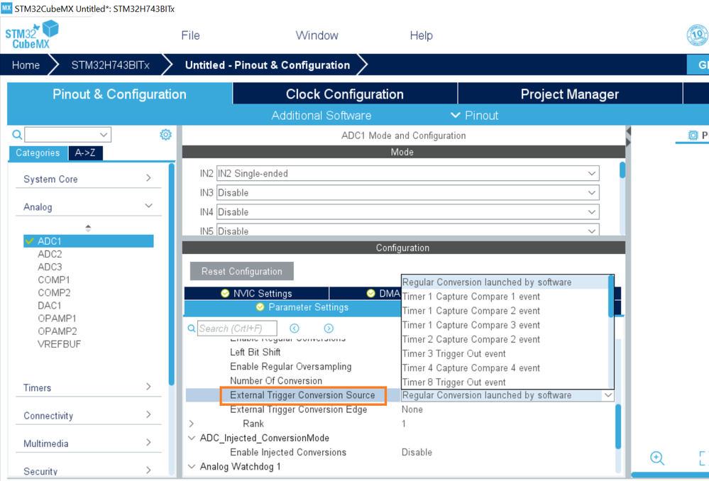

Hello @ETone
Please see attached picture , from there, you can set the external trigger source :

2020-03-18 6:18 AM
Thanks for the quick reply! This is connecting the timer to trigger a conversion. I want the adc watchdog to trigger a timer reset.
