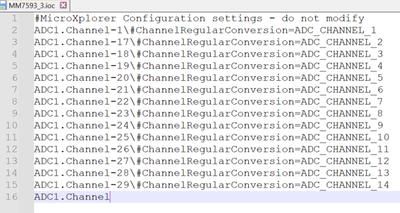

The fault was in STM32CubeMX, that did not save correctly.
During my work I experienced the software closing without saying a word on the error, especially in the ADC1 setup. But every time I could just start it again, but not this time:-(
Attached you find the surviving part of the IOC file.
Thank you for listening to my disaster.

After investigation, I confirm that the Ioc provided is corrupted.
Could you provide please more details about the issue.
