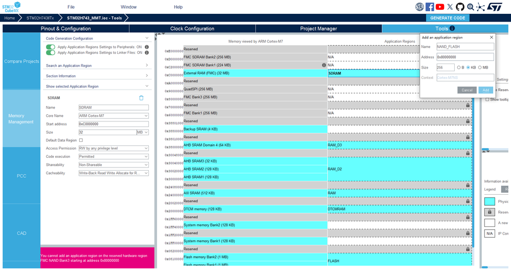

When I used the MMT tool in STM32CubeMX to configure a 256MB NAND FLASH based on FMC, an error appeared. I am using the STM32H743IIT6 chip and have configured NAND FLASH in the FMC. I want to know how to solve this problem.

Hello @hhywyh ,
While adding an application region you need to check the region availability. (Adress and Size)
Further to the screenshot shared, FMC Bank 3 is reserved.
Thanks.
Mahmoud

Hello @hhywyh ,
Thanks.
Mahmoud
