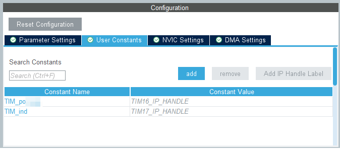

2026-03-19 8:07 AM
@unsigned_char_array wrote:
To my knowledge only GPIO macros have lower case in them. But I could be wrong.
Also applies to User Constants; eg,
Although these are all user-entered - so, if you want an uppercase-only policy, then don't enter lowercase in any of these fields.
