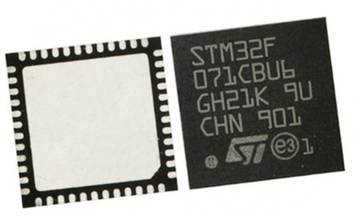

This is a UFQFN48 chip, which doesn't have leads. It shows in the dashed boxes because the pads are on the bottom of the chip and it's trying to visually replicate the layout.
On LQFP they're shown on the outside of the chip. On BGAs they're shown as circles on the chip where the balls are underneath.
