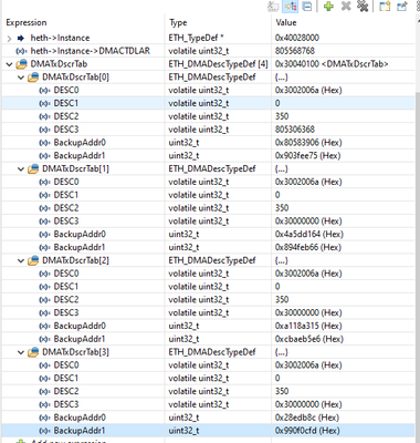

The sequence is ok, it runs up to sending the ethernet frame with HAL_ETH_Transmit(), but Wireshark does not show a packet on the wire. I have checked the DMACSR, its content is 0x404. This means the Bit TBU is set and indicating
Bit 2 TBU: Transmit Buffer Unavailable
This bit indicates that the application owns the next descriptor in the Transmit list, and the
DMA cannot acquire it. Transmission is suspended. The TPS0 field of the
DMA_Debug_Status0 register explains the Transmit Process state transitions.
To resume processing the Transmit descriptors, the application should do the following:
1. Change the ownership of the descriptor by setting Bit 31 of TDES3.
2. Issue a Transmit Poll Demand command.
For ring mode, the application should advance the Transmit Descriptor Tail Pointer register of
a channel.
I don't quite understand this and also why this could happen. What can I do?
this is the TxDescriptor list:
