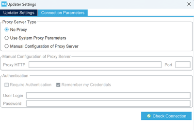

So the Windows update does nothing and as for the UPDATER SETTINGS when I click on "Check Connections" it seem OK. I'll try to upload some picture of the pages I have .
