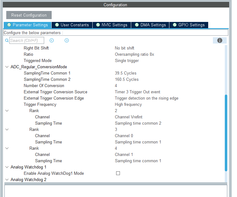

I am trying to setup an ADC to read 4 different inputs. TempSensor, VRefint, Channel 0 and Channel 1. When I tell it number of conversions = 4 It lets me Fill in Rank 2, 3, and 4, but not Rank 1. I thought this worked before.
I uninstalled the ST IDE, and MX programs and reinstalled.
Same issue. What am I doing wrong?
Did something get corrupted?
STM32CubeMX - STM32 Device Configuration Tool
Version: 6.5.0-RC4
Build: 20220225-1913 (UTC)
2022-06-06 9:08 AM
Hello @KiptonM,
Thank you for your fast response,
This is a known issue and has already been reported internally. It will be fixed as soon as possible.
Internal ticket number: 121506 (This is an internal tracking number and is not accessible or usable by customers).
Beside the workaround you mentioned, you can also try deselecting the ADC channels and reselecting them then repeating the parameter configuration for ADC.
We apologize for the inconvenience.
Best regards,
Aziz

2022-06-06 9:20 AM
I deselected the ADC channels saved it, closed the program. Started it again, Selected the channels, and reconfigured the ADC, and it is working now.
Thanks,

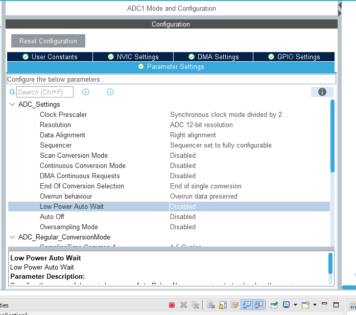

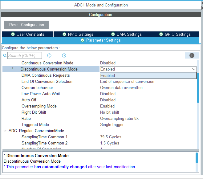

2022-06-07 2:26 PM
There is surely something weird going on.
I decided to go back and change the modes.
Discontinuous Conversion Mode is Enabled, but the MX program dos not have a pull down option to disable.
In the comment it says Discontinuous Conversion Mode
* This parameter has automatically changed after your last modification.
Scan Conversion Mode is Enabled, but it will not let me Disable. It is in the pull down menu but it is grayed out.
Attached is the .ioc file.
2022-06-07 2:32 PM
I decided to Press the Reset Configuration Button and reenter the values.
The choice for Discontinuous Mode is gone! It was between Continuous Conversion Mode and DMA Continuous Requests.
Fortunately I am not interested in Discontinuous mode at the moment.
Thought you may want to know.
