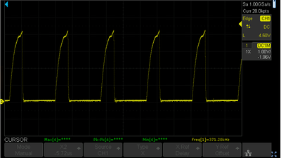

I’m currently working on an I2C communication setup using the Nucleo-H753ZI DK but the cubeMx document is for the STM32H743BIT (the MCU for my custom board) and aiming to run it in Fast Mode (400 kHz). However, when configuring the I2C clock speed to 400 kHz, the CLK signal becomes unstable, as shown in the attached image.
To ensure the setup is functioning correctly, I ran tests with I2C configured at 100 kHz, and the communication works perfectly in that case.

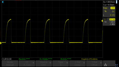

Hi Padawan,
I am using an oscilloscope to measure the frequency, and the resistor reduction was made to achieve the correct waveform for the CLK signal.
For the pull-up, I am using 5V.
Attached are some measurements I have taken with different resistor values and VCC levels:

2025-03-11 4:29 AM
I2C is not a fixed speed. It must wait (per the I2C spec) until a specific voltage is reached during the rising clock cycle. Since your edges are slow, the final clock speed is lower than 400 kHz. You can see the speed increase as your pullups get stronger.
A clock speed of 370 kHz or lower does not pose a problem in terms of communication.

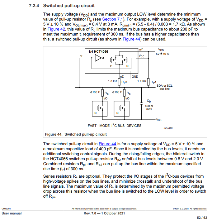

2025-03-11 4:38 AM
@JonConesa wrote:What would you recommend?
You need to give more details of your setup.
It seems you have very high capacitance - why is that?
Maybe you need something better than just a simple pullup; eg,
https://www.nxp.com/docs/en/user-guide/UM10204.pdf#page=52
Bus "Accelerators" are available; eg,
https://www.analog.com/en/products/ltc1694.html
