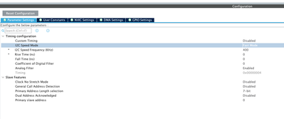

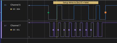

I’m currently working on an I2C communication setup using the Nucleo-H753ZI DK but the cubeMx document is for the STM32H743BIT (the MCU for my custom board) and aiming to run it in Fast Mode (400 kHz). However, when configuring the I2C clock speed to 400 kHz, the CLK signal becomes unstable, as shown in the attached image.
To ensure the setup is functioning correctly, I ran tests with I2C configured at 100 kHz, and the communication works perfectly in that case.

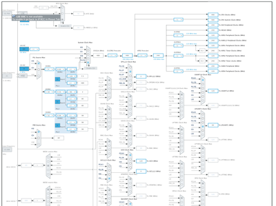

I’ve also included an image of the system clock configuration in case there’s something that could be optimized.

Increase the logic analyzer sample rate. Looks like it's just too slow to capture things at the resolution you're expecting. Compare sample rate to time between edges. Probably you only have 1-2 samples per pulse here.

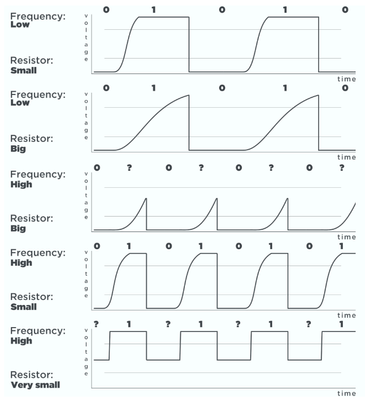

The higher the speed, the lower go with the pull-up. These pull-ups form a RC low-pass element with stray and parasitc capacitances. Higher currents allow for a fast charge/discharge, and thus higher bandwidth.
> As for the logic analyzer, I’m using a Saleae Logic 8 with a 10 MS/s sampling rate.
You cannot assess signal quality with a logic analyser, which have fixed L/H thresholds.
You need a scope for that.
Logic analysers are (only) good for recording and decoding digital signals.
