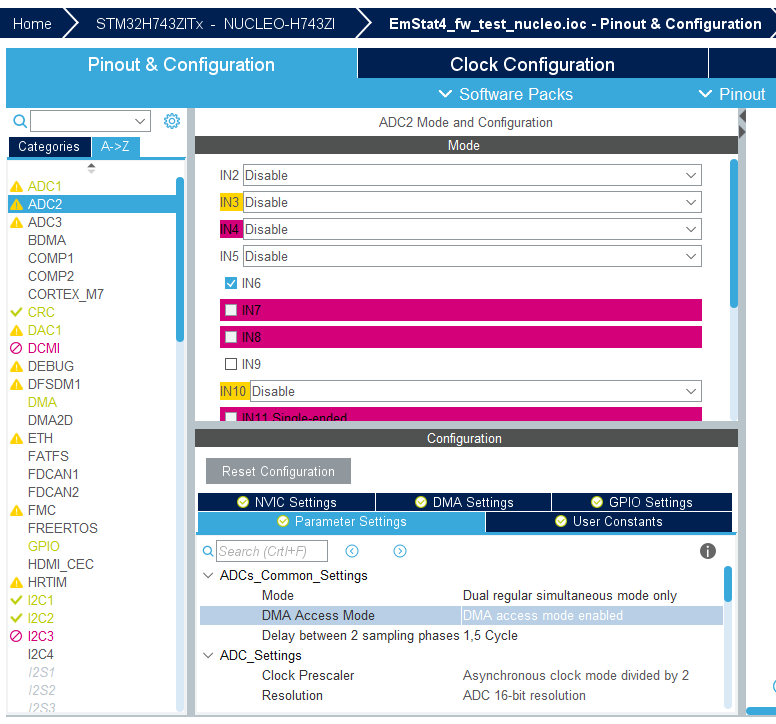

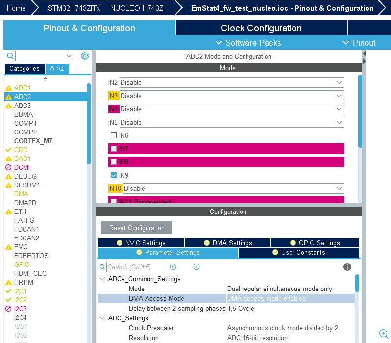

Hi @Wde G.1
Thanks for the feedback,
It is a normal behavior :
when we change the input (for example IN9 to ===> IN6), DMA ACCESS MODE still enabled.
When we unchecked IN9 for example then check IN6, DMA access mode change to Disable and to enable it you should go to ADC1 and change it to enable.
Best regards,
Nesrine
2020-05-07 12:53 AM
Thank you Nesrine!
If it's normal behavior then it ok once you know it ;)
Regards,
Walter.
