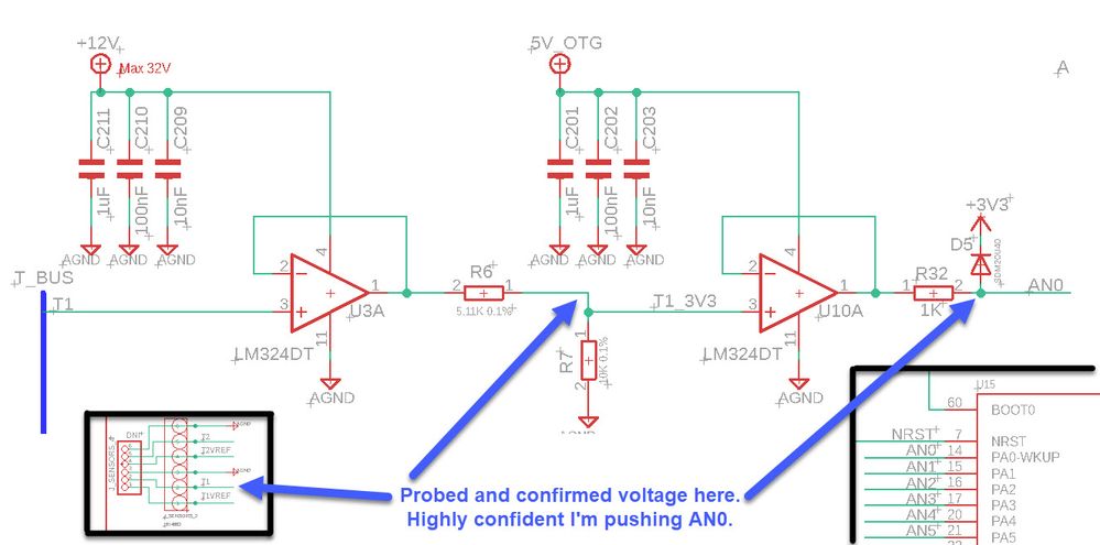

I'm individually driving my AN0..AN5 analog inputs, and I've confirmed that the ADC results are showing up in ADC_DMA_BUFFER[1..6]. I would have expected them in ADC_DMA_BUFFER[0..5]. Meanwhile, I'm configured for 7 conversions, the 7th being AN14. It's not showing up in either ADC_DMA_BUFFER[6] (the normally expected location) or ADC_DMA_BUFFER[7] (an otherwise buffer overflow location that was hinted at by the behavior of the first 6 channels). Finally, I'm unable to test if AN14 is erroneously going into ADC_DMA_BUFFER[0] (which would be a looped-back index location).
I've analyzed everything and I believe it's all lined up properly. Why might this be happening? Below is select cut/paste/images from my code and circuit. Thanks in advance for your help!
