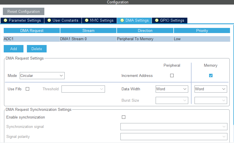

DMA stream0 for adc1 6 channels.
DMA stream1 for adc3.

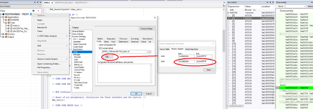

I have made a test to check and I don’t have any problem to read the values for ADC1 (DMA stream 0)
You should change the memory address, as shown in Figure (when using IAR)
Please see the RM0433 Rev 6 (page 101, 128) for more clarification
