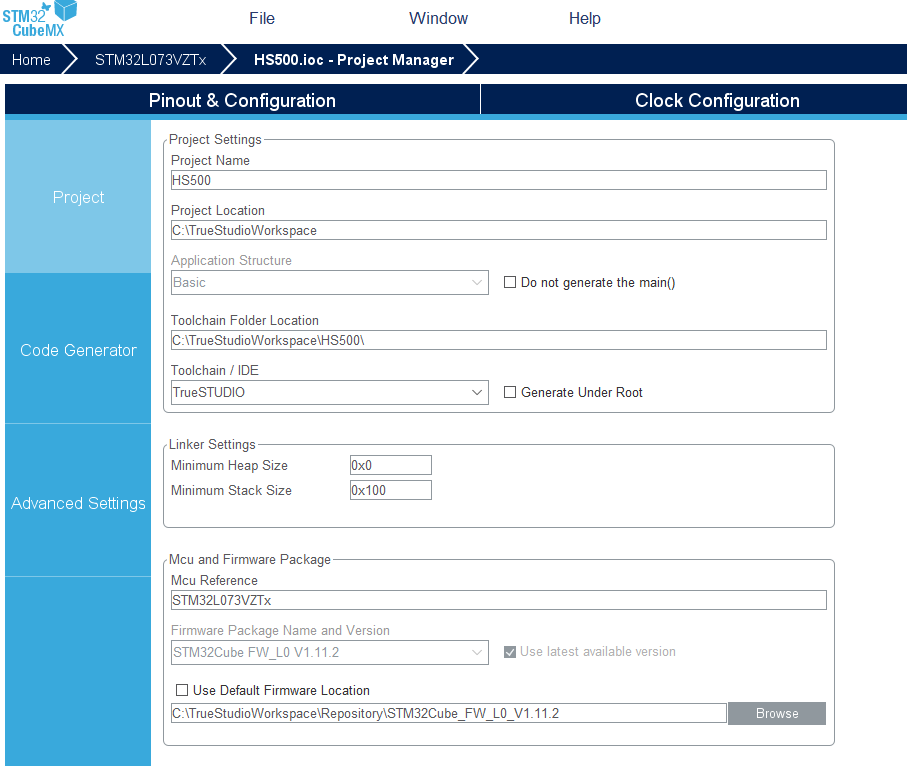

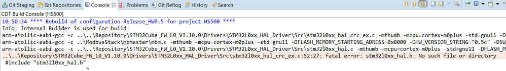

I have problems with adding the repository of CubeMx into the Truestudio workspace. I wanted to update my existing project to Repository 1.11 (from 1.10), using the latest cubeMX version. But somehow I can not compile anymore now, as the Compiler can't find the include files anymore.

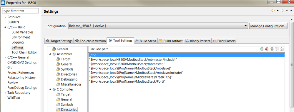

It seems like it is still searching for the repository V1.10, but I don't know why or where I can tell which repository to use. My repo lies under
C:\TrueStudioWorkspace\Repository\STM32Cube_FW_L0_V1.11.2
thanks very much for your help!

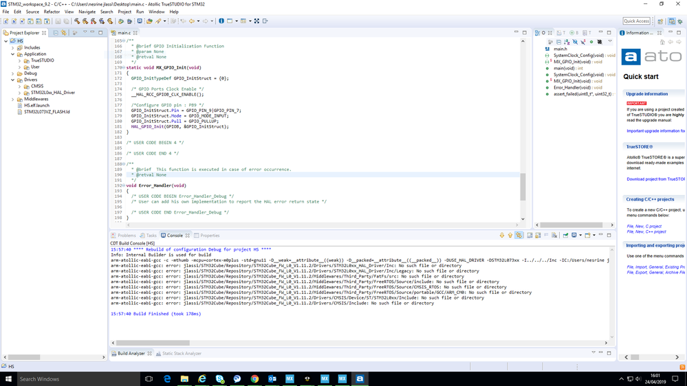

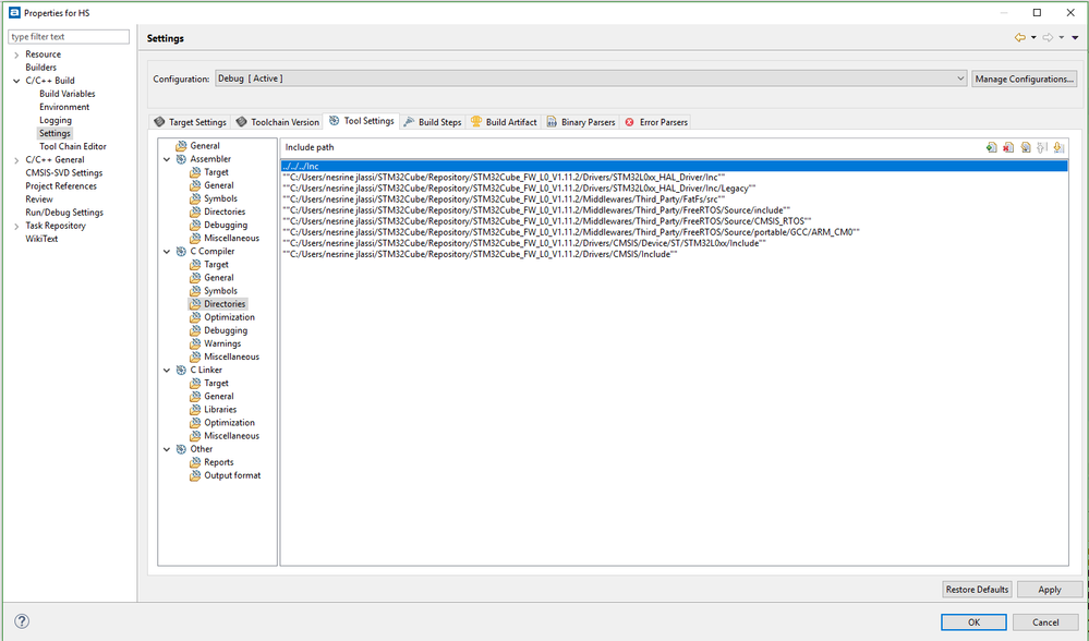

Could you please send me your .ioc file to check the problem?
