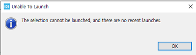

Issue: When I try to debug the project I get the following error, I dont know what went wrong but I have just followed the turtorial on the official website.

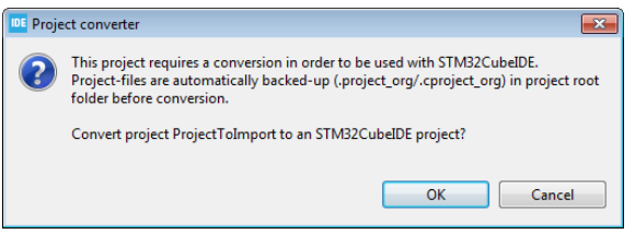

Another Issue?: According to this guide, a dialog box asking to confirm the project conversion is then displayed as shown in the below, just after importing the project into IDE, but in my case, the box isnt appearing.

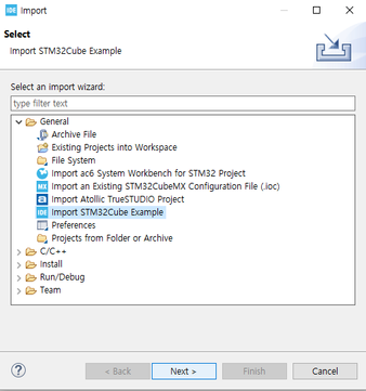

At the moment I found an alternate way
File -> Import -> Following window shows up Import Example
Expand General -> Select Import STM32Cube Example -> Next

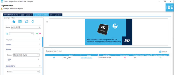

Target Selection window will showup
first select Board and then Example NameTarget Selection
