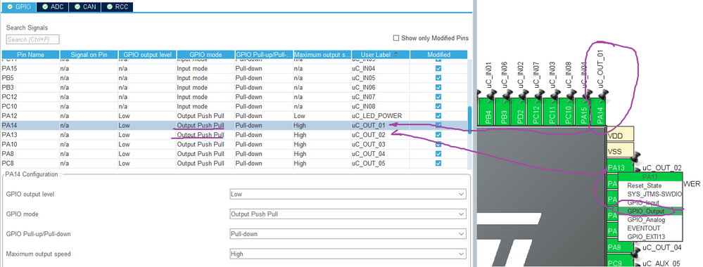

I swear i was able to do this in the past but then ...... then i updated from 6.3.0 to cubeMX 6.6.1.
Maybe thats the reason, maybe not .
Im using a stm32f105RBT6
When i flash the chip and remove the stlink both PA13 and PA14 are stuck into some idle 1,3V floating state instead of toggle each second like PA10
I am not sure where should i look to be sure pin SW functions are not on.
Setting up pins as GPIOs in cubeMX
Code inside main, simple GPIO toggle

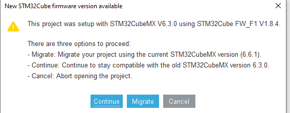

Thanks @Herve PIERROT , ill give it a look to AN4989 and get back to you with my findings.
What troubles me is... i never had this problem before untill now, and im using both SW pins as alternative functions in the same hardware with other projects.
Ill downgrade to cubeMX 6.3.0 also
2022-11-24 6:33 AM
@Herve PIERROT , i already fixed it , there is nothing wrong with cubeMX nor the firmware package.
I just deleted the project, generated everything again with cubeMX 6.6.1, copied my libraries and now its fine.
Something went wrong when i updated CUBEMX and regenerated the progect, i believe the issue was in the files autogenerated by cubeMX at that point.... but i dont have the time to figure out what, anyway everything is working now.
