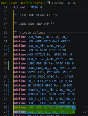

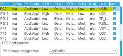

So I have a series of PIN configured as Application and/or Boot only but, for some reason, the CubeMX generates the code on both main.h in Appli and Boot
i.e.
I have PC0 set as Application only context but I found it in the Boot as well

Hello @nico23
Let me thank you for bringing this issue to our attention.
The issue has been escalated to the development team under this internal ticket: CDM0062424
I will let you know as soon as the problem is solved.
Thanks.
Mahmoud
