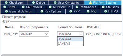

I see some potential problems in the current CubeMX setup:
1) PHY must be setup in Ethernet AND LwIP tab.
As the single responsibility theory says: one should setup only in 1(one) place.
2) If USER_PHY is selected , then USER_PHX calls should be generated, and not omitted as now.
3) USER_PHY creates warning, but it should be an accepted solution ...

I'll second this; I'm running the CubeIDE 1.13.0 & FW_H7_1.11.1 on a custom board. ST only includes a driver for the LAN8742. It is very annoying that the only other option is Undefined and a custom BSP module can't be provided for Cube to be aware of.

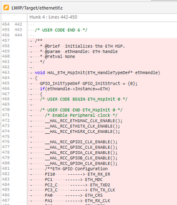

Not only does this produce a warning every time code is generated, but it also then just removes the HAL_ETH_MspInit and MspDeInit function from being generated for no reason. The GPIO configuration should have nothing to do with which PHY driver is selected.
Obviously the current setup can be worked around (and is still preferred over the legacy version IMO), but it's just clunky. For anyone else, I generated code first with the LAN8742 driver, re-generated with it turned off, and ran a file difference between the two to ensure I filled in all the missing functionality.
