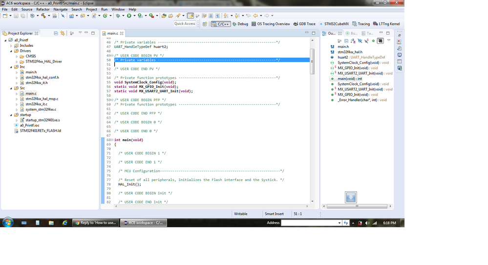

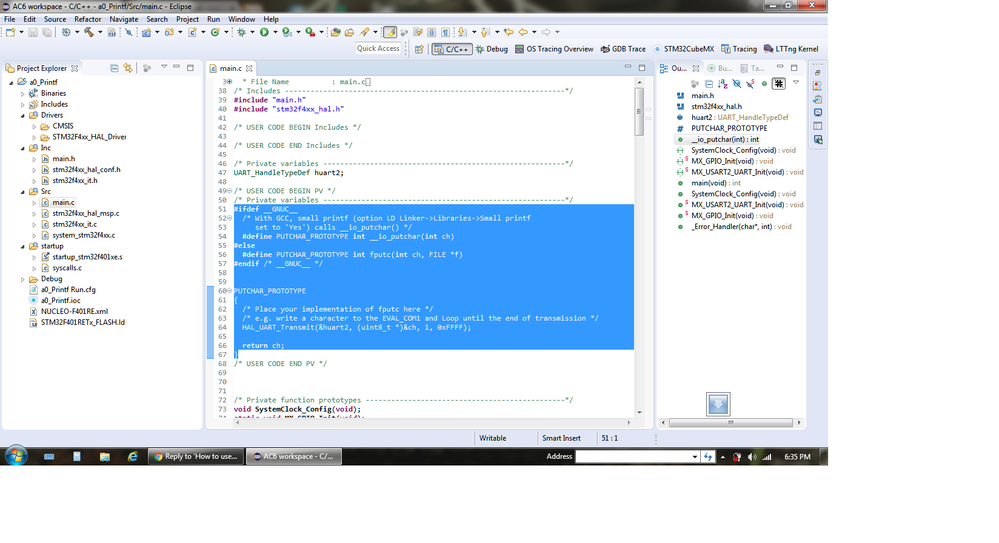

Step 1 Let's add the following two function in our main.c - you can place them above the main() function
in my case i paste it on /* USER CODE BEGIN PV */ see highlighted
#ifdef __GNUC__
#define PUTCHAR_PROTOTYPE int __io_putchar(int ch)#else #define PUTCHAR_PROTOTYPE int fputc(int ch, FILE *f)#endif /* __GNUC__ */PUTCHAR_PROTOTYPE
{ HAL_UART_Transmit(&huart2, (uint8_t *)&ch, 1, 0xFFFF);return ch;
}see pic below

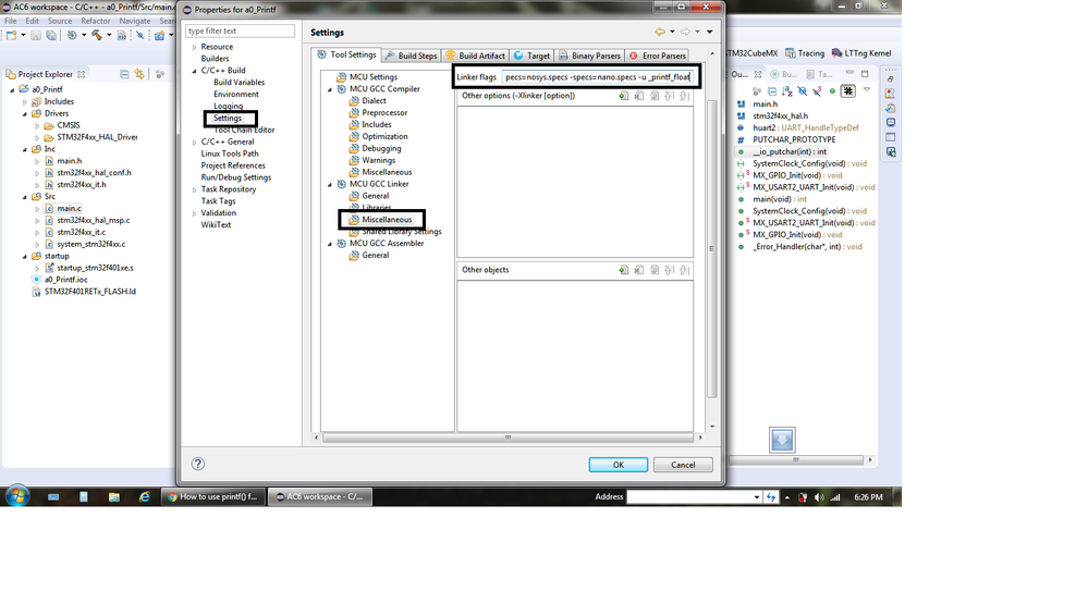

Step 2 : Modify the linker flag in the project properties.
2.1 Go to Menu: Project\Properties\
2.2 Expand C\C++ Build on left pane, select Settings
2.3 On middel expand MCU GCC Linker drop down menu, and select Miscellaneous
2.4 Now on the rightside you can see the the ''Linker Flag'' text box.
2.5 Replace/update the text to
-specs=nosys.specs -specs=nano.specs -u _printf_float
Hit Ok

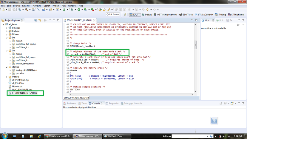

STEP 4: I did check on STM32F401RETx_FLASH.ld file (on file exporer, its the file on the last - see picture) as suggest in the comment above and it is
0x20018000 by default so i leave it as is.
/* Highest address of the user mode stack */
_estack = 0x20018000; /* end of RAM */FINAL STEP. Finally I tried and run inside loop
