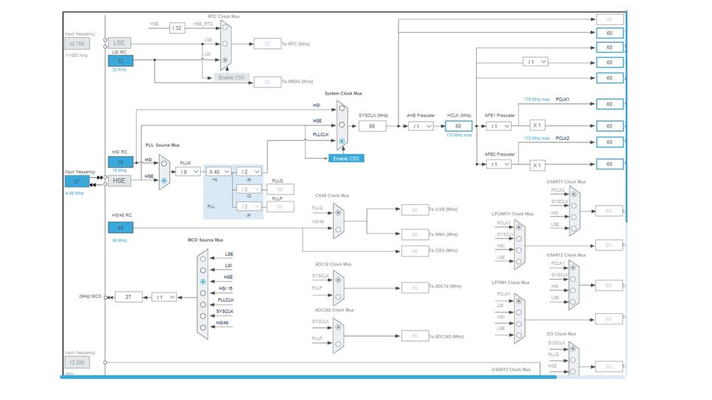

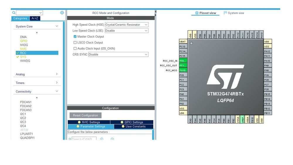

I am working with a STM32G474RE and I want to use a MCO as an output of HSE(27MHz).
I used STM32CubeMX Ver.5.6.1 for generate simplest init. code, which would work only for MCO function at PG10 Pin.
here's my setup.
I builded the init. code by SW4STM32 without any modification.
27MHz crystal is connected betoween PF0 and PF1.
I measured wave form at PG10 and PA8 Pin by oscilloscope.
PG10 wave form was tied to 3.3V DC, and PA8 wave form was 27MHz clk signal.
I thought that I must write something to set PG10 as standard GPIO in order to avoid confliction with NRST function. Therefore, I can't find how to do it.

2020-04-17 3:16 AM
You need to enable PG10 as GPIO pin, see description of PG10_Mode field in option bytes, and the Using PG10 as GPIO chapter in RM.
Note that you will lose the possibility to reset the chip using a signal, i.e. you won't be able to "connect under hardware reset" the debugger (useful e.g. if you change the functionality of SWD pins in software).

2020-04-17 5:30 AM
Thank you for your advice.
I read reference manual and HAL API and tried some of programs.
But, My work hasn't been going well.
PG10 seemed to work, but the clk signal amplitude was lower(1Vpp) than expected(3Vpp).
On the other hand, PA8 output was 3Vpp clk signal, which freq. is the same as PG10.

2020-04-17 5:37 PM
How was GPIO_OSPEEDR set for PG10?
2020-04-17 6:18 PM
That setting was "LOW" when PG10 output was 1Vpp.
I modify it as GPIO_OSPEEDR = "VERY_HIGH".
Now, PG10 output amplitude become 3.3Vpp!!
And, PA8 still output the same signal as PG10.
