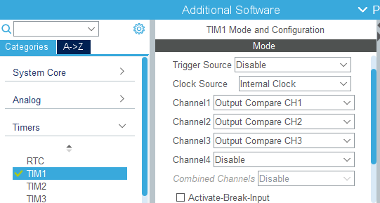

I am configuring the 3 of TIM1's channels as Output Compare:

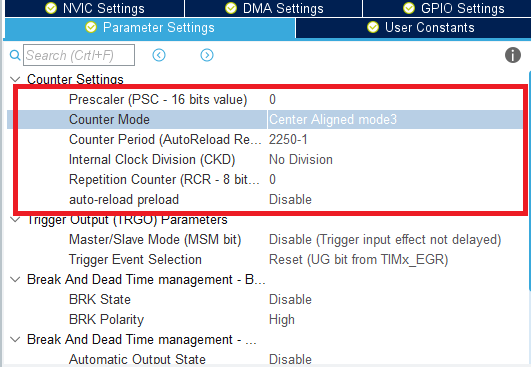

Then i choose the Center Aligned_3 mode and setting the frequency on 16KHz (frequency is correct):
Finally, every channel has the same settings as below:
With CubeMX's default code, i am just starting the OC and setting the desired pulse:

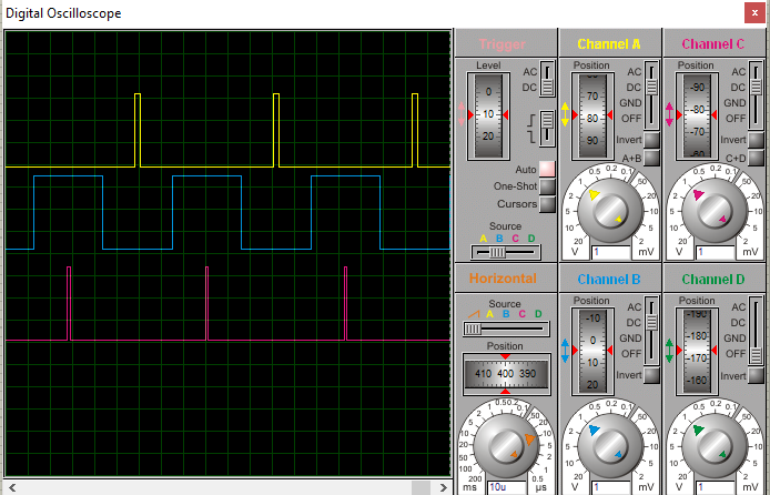

TIM1->CCR3 = 2200; //Channel_3 ~ 2% Duty CycleAnd on simulator everything is correct:

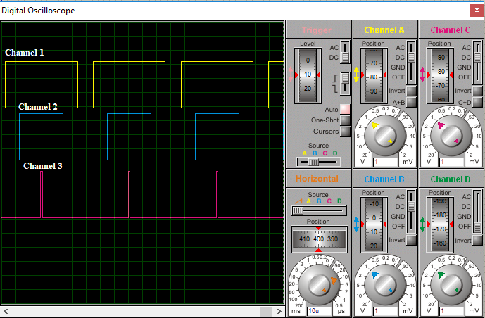

If we change the CCR1 to lower value:
TIM1->CCR1 = 100; //Channel_1 95% Duty CycleSeems like Channel 1 is not aligned with the others, like it is shifted:

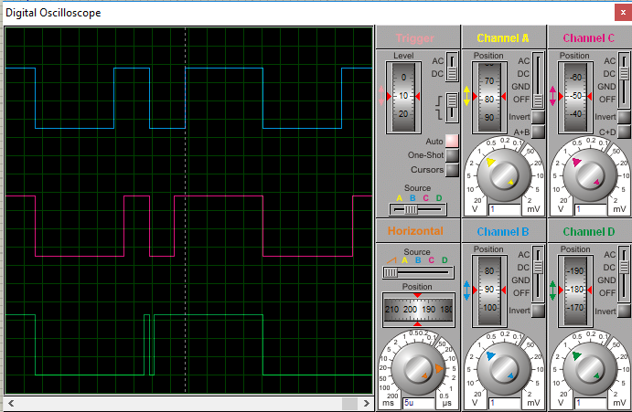

}The output looks like this:

Due to quarantine, i have not access to oscilloscope. That's why i am using simulator.
I don't think the problem is Proteus-Simulator.
