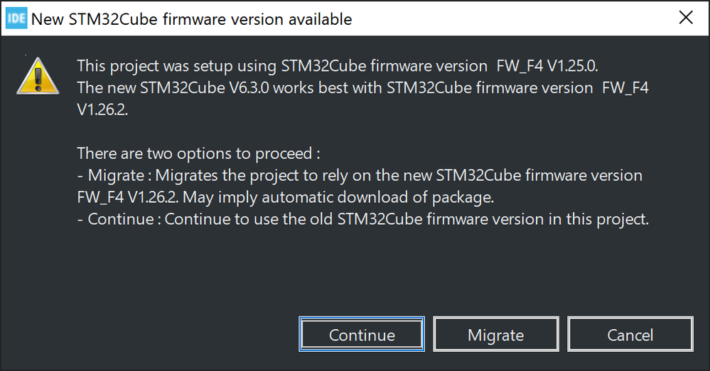

You'll get a screen like this. Make sure you don't blindly click through.
Looks like it is not selectable per se. You can only migrate upwards.

OK, that would be good.
If one decides to not migrate and then some time later wish to do that, is that possible in Cube?

Excellent, thanks so much for helping alleviate my concerns.
IOC is always in a git repo so in the event I "click through" that dialog incorrectly I should be OK :)
