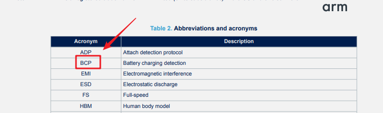

Hi @FBL :
I think there is a typo here.

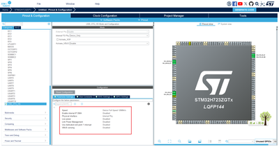

And I don't find STM32H723, does this chip support BC1.2?

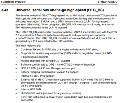

I can't configure BC1.2 in STM32cubeMX, but datasheet say it supports.

Thank you for reporting this!
We’ve created an internal ticket (214023) and passed it on to the team to get it fixed.
Yess, according to datasheet, STM23H723 supports BC1.2
