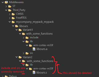

This is how it looks like when I switch from one variant to the other.
I also noticed that it even keeps the path for the library when linking:
-L../Middlewares/Third_Party/mycompany_mypack/libours/lib/arm-cortex-m33f
-L../Middlewares/Third_Party/mycompany_mypack/libours/Varian1/with_some_functions/lib/arm-cortex-m33f
-L../Middlewares/Third_Party/mycompany_mypack_mypack/libours/Varian1/with_some_functions/lib/arm-cortex-m33f
-L../Middlewares/Third_Party/mycompany_mypack_mypack/libours/Varian2/with_some_functions/lib/arm-cortex-m33f
