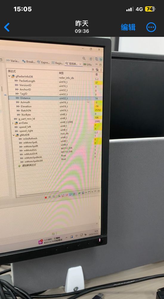

If I can say freely, there will some wired things happen in the STM32CubeIDE, when I debug an "uint16_t" variable(like: Azimuth, in the blew picture), the value displayed can be a "-3"? I think this should be a bug.

Regarding the Live expression wrong data :A ticket has already been escalated to the development team to address this issue (internal ticket ID: 175214).
