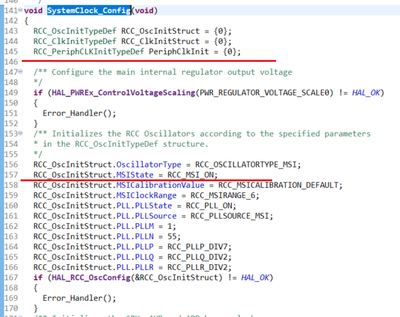

I have this example as I said at the beginning of my topic. And in this example (FatFs_uSD_Standalone) I have this code in the function void SystemClock_Config(void) :
RCC_PeriphCLKInitTypeDef PeriphClkInit = {0};
if (HAL_PWREx_ControlVoltageScaling(PWR_REGULATOR_VOLTAGE_SCALE0) != HAL_OK)
Error_Handler();
RCC_OscInitStruct.OscillatorType = RCC_OSCILLATORTYPE_MSI;
RCC_OscInitStruct.MSIState = RCC_MSI_ON;
RCC_OscInitStruct.MSICalibrationValue = RCC_MSICALIBRATION_DEFAULT;
RCC_OscInitStruct.MSIClockRange = RCC_MSIRANGE_6;
RCC_OscInitStruct.PLL.PLLSource = RCC_PLLSOURCE_MSI;
RCC_OscInitStruct.PLL.PLLM = 1;
RCC_OscInitStruct.PLL.PLLN = 55;
RCC_OscInitStruct.PLL.PLLP = RCC_PLLP_DIV7;
RCC_OscInitStruct.PLL.PLLQ = RCC_PLLQ_DIV2;
RCC_OscInitStruct.PLL.PLLR = RCC_PLLR_DIV2;
Error_Handler();
RCC_ClkInitStruct.APB2CLKDivider = RCC_HCLK_DIV1;
if (HAL_RCC_ClockConfig(&RCC_ClkInitStruct, FLASH_LATENCY_5) != HAL_OK)
Error_Handler();
PeriphClkInit.PeriphClockSelection = RCC_PERIPHCLK_SDMMC1;
PeriphClkInit.Sdmmc1ClockSelection = RCC_SDMMC1CLKSOURCE_PLL;
Error_Handler();
}This part of code is very strange and misplaced
I was looking for something that I already had since I configured it in my .ioc file via STM32Cube IDE but which is placed elsewhere not in the function 'void SystemClock_Config(void)' but in the function 'void HAL_SD_MspInit(SD_HandleTypeDef* hsd)'. Thus It's impossible to compare to something that is not comparable. Why are you hiding the '.ioc' file in the FatFs_uSD_Standalone example ? What is your interest in wasting developers' time ?

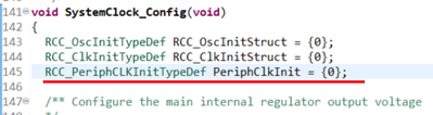

2024-06-27 1:59 AM
I would like to know how to have the configuration have the same code from the STM example via the .IOC file.

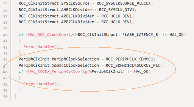

The example has this code

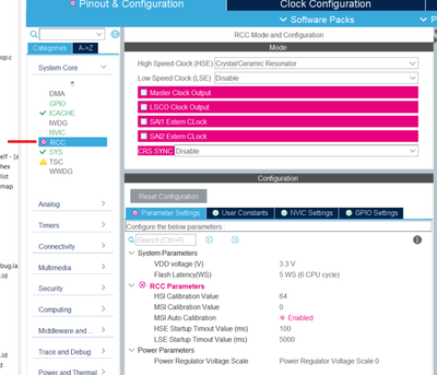

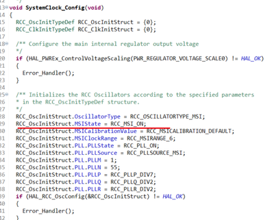

Via my STM32CubeIDE, after configuring my Clock Configuration I can have this code
I'm missing this line below, is this really important ?
And my .ioc file has a red cross
Do you have any idea how to configure my clock to have the same code as the example provided by STM ? Thank you for your helps.
