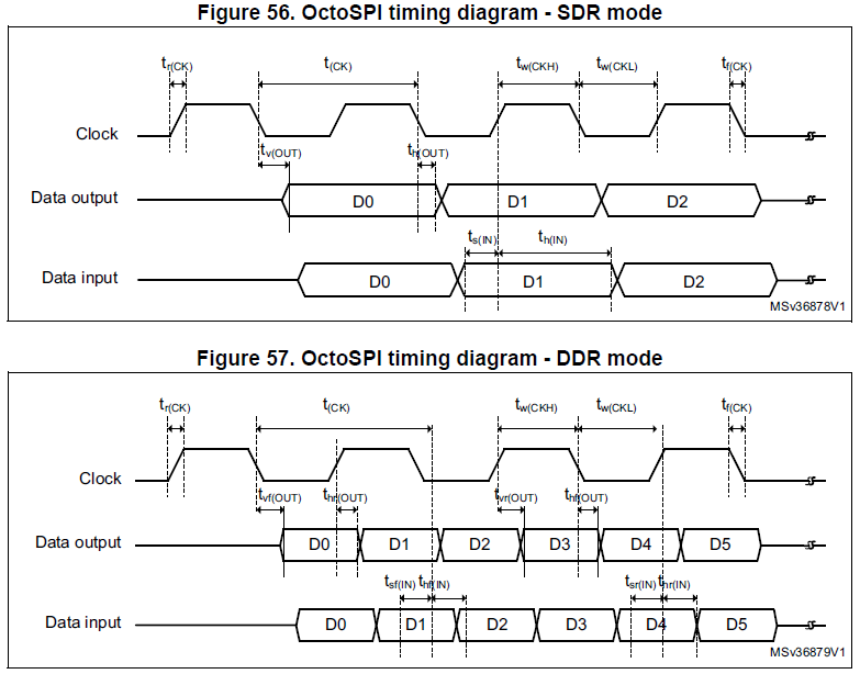

Just read RM0432, section 19.4.3. Instruction, address, alternate are "send to slave only", dummy is nothing at all, data is either "send to slave only" or "read from slave only" (depending on memory-mapped/indirect write or read).
The diagrams below are just for brevity, instead of showing two separate diagrams for both directions, they're combined into one. That's well-known and well-established convention, see e.g. datasheet of MC6821, Fig. 1 Bus timing as of 1985(!!!).
2022-04-06 3:31 PM
I'm a read behind/between the lines guy, with a background in IC design and validation.
It's the absence of anything supporting concurrent operation that is the most glaring here. The complexity of the implementation and the diagrams would be around 2x if the FIFO and registers were capable of sustaining duplex operation, the status and control also lack. The IC designers are going to choose the least complex/least transistor approach unless beaten by management to burn more resources. Efficiency and elegance of the design is where you shine in the team
See USB, it's also one of these things where the channel is unidirectional in operation, but can switch.

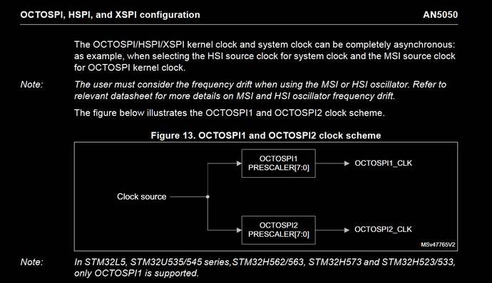

im not sure but that and you can try the following plan to imeplement the full duplex mllti spi which transport byte revelop to the bit at each channel .
the menu dm00407776 show that the octoSPI 1/2 in common clock source hence user can use octoSPI 1 as “muli MISO ”and octoSPI2 “as muli MOSI ” vice versa ,octoSPI1/2 driven by same time sequence to fulfil full duplex SPI
that is feasible or ont depend on the specific characteristic of target chip
