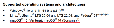

Are you using these MacOS versions?
From STM32CubeMX V6.12.1 release note:
2024-10-26 4:42 PM
@mƎALLEm , .I am sorry for replying too late. macOS14.6.1 on Mac M2.
2024-10-31 7:50 PM
Sorry for the late reply - I'm running MacOS 13.1, with an Intel CPU
