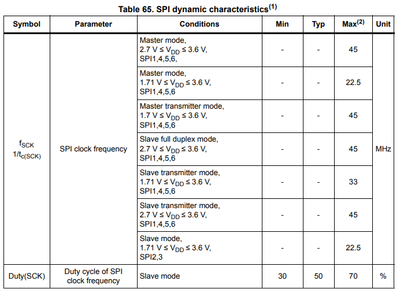

Why are you looking for the minimum freq value?
Only maximum values are provided in the datasheet:
And you can go downto 1MHz for SPI

The minimum required by the EMB1428QSQ will be specified in the EMB1428QSQ datasheet;
The minimum that can be provided from the STM32 will be specified in the STM32 datasheet and/or Reference Manual:
