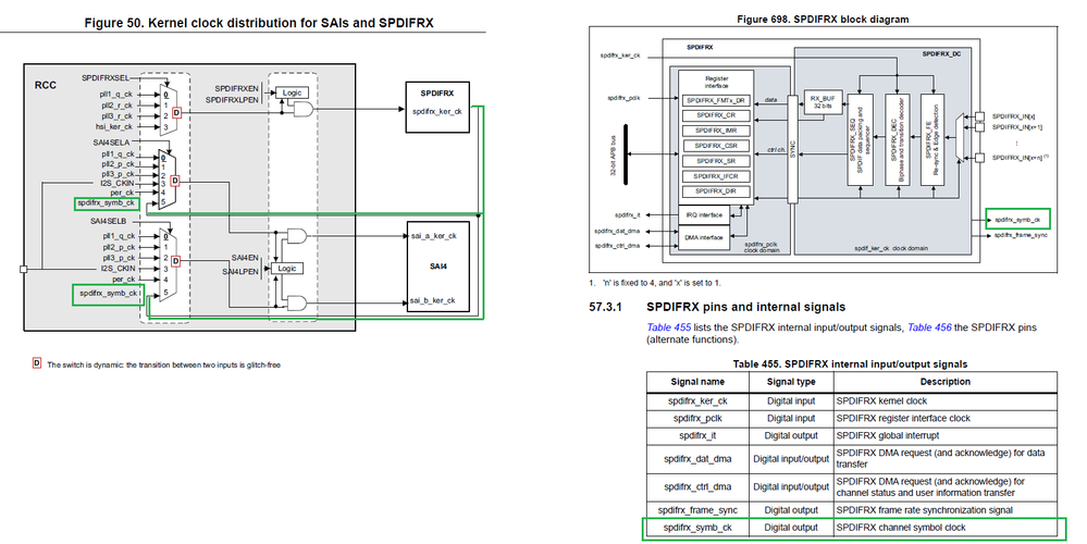

As mentioned in the STM32H723/733, STM32H725/735 and STM32H730 User Manual, the SPDIFRX block can provide a symbol clock on signal named spdifrx_symb_ck, which can be used as the reference kernel clock for another audio device such as SAI4.

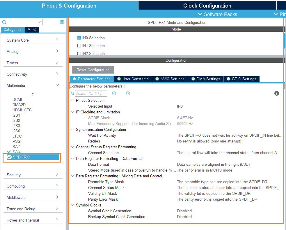

SPDIFRX can be configured through Pinout & Configuration view > Component List:

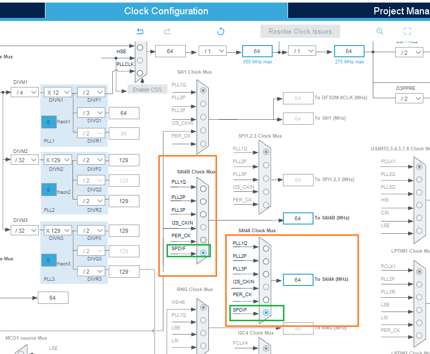

Concerning the selection of spdifrx_symb_ck as the clock source for SAI4, this could be done through Clock Configuration view > SAI4A/B Clock Mux:

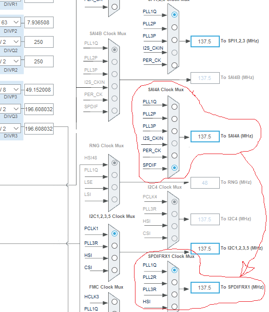

If you look at the following screen capture from an STM32H730ZBT6 configuration from STM32CubeIDE:
You will see that it indicates that the SPDIF input to the SAI4A Clock Mux appears to be sourced from the SPDIFRX1 Clock Mux, and not the spdifrx_symb_ck. Either the GUI is wrong, or your above statement is wrong, I'm not sure which one it is. Could you please clarify?
It is a little confusing for the user that the clock speed is shown as the output of the SPDIFRX1 Clock Mux, rather than a different value to indicate that it's sourced from the spdifrx_symb_ck.

Actually, and as I've already mentioned, spdifrx_symb_ck is the output signal provided by SPDIFRX block:
This output symbol clock on signal named spdifrx_symb_ck, can be used as the clock source for SAI4s (which presented as SPDIF in the SAI4 Clock Mux in STM32CubeMX).
Thus, I see no mismatching between STM32CubeMX clock tree and the STM32H723/733, STM32H725/735 and STM32H730 User Manual ( spdifrx_symb_ck is the SPDIFRX channel symbol clock digital output = clock that can be selected as kernel peripheral clock for SAI4).

Thanks @Khouloud OTHMAN I appreciate the response.
My point above was that the clock rate when set to spdifrx_symb_ck should be relative to the incoming SPDIFRX data, but in the STM32CubeIDE interface, it is shown as the clock frequency coming out of the SPDIFRX1 Clock Mux.
It would be less confusing for the user, IMO, if the clock rate shown in the SAI4A or SAI4B Clock Mux when set to SPDIF as an input, was a "?" character or similar, to indicate that it was variable. In the current interface, it looks to be something it isn't.
