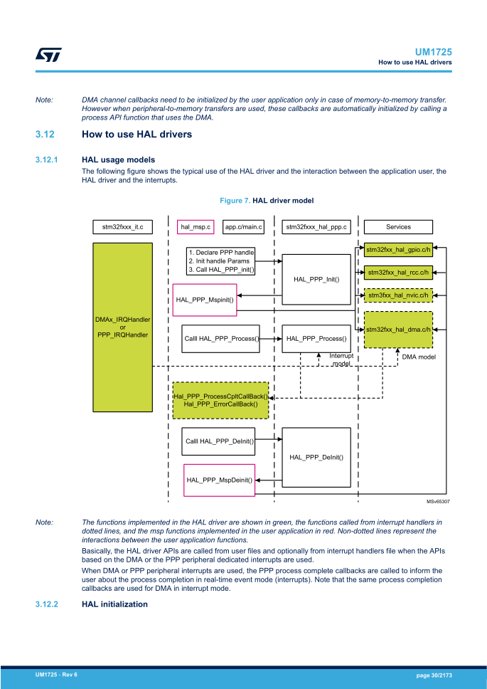

I don't Cube, but AFAIK they like to put these things into a "MSP" callback, to be called from the timer initialization function, probably in a separate .c file (stm32XXXxx_hal_msp.c ?)
PS. You've surely familiar with the Cube/CubeMX documentation:

Excellent. You were correct, it is set up in stm32f4xx_hal_msp.c
I find it a little odd that most of the user defined setup is in main.c, and some bits in the _hal_msp file.
However, I am only just starting out with this, so I can't be critical!
Also, thanks for the reference to the HAL drivers documentation, I need to refer to it more!
