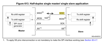

In cube, the SDI pin is mapped to SPI2_MISO, PB14. But as a slave, shouldn't the correct SDI pin map to SPI2_MOSI, PB15?

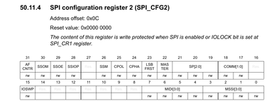

Seems to be a bug , but no big problem, miso mosi can be swapped :
So let Cube do it, and if the pin swap missing, just set it yourself in the init.
  hxxx.Init.IOSwap = SPI_IO_SWAP_DISABLE;   // or _ENABLE
A half duplex data connection on the slave side should be on the MISO pin, as shown in the reference manual.

This IO swapping method is much better than manually modifying the init code, which will be wiped when cubeMX regenerating.
I didn't find the struct member 'Init.IOSwap' in &hi2sx, it just exist in struct &hspix.
But I find this function for I2S - HAL_I2S_EnableIOSwap, which also works.
Added this line, and changed the phyical data pin connection to PB14, works just fine.
HAL_I2S_EnableIOSwap(&hi2s2);

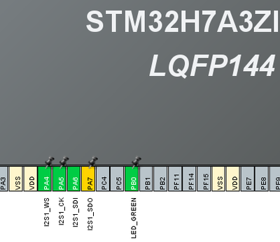

This problem still persists for the STM32H7A3 in CubeMx v6.17. I worked around it by configuring the PA7 pin separately, but it’s not a clean solution.
