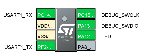

The Tx pin is just connected to an oscilloscope and the chip is in a breadboard with the only connections being its power rails, an LED on a GPIO pin and the ST-Link on the SWD pins.
There isn't much code at the moment other than what was generated by Cube MX. The chip is an 8-pin device so the pins have multiple functions but only USART1 and SWD are enabled.
However you have got me wondering now - the TxD pin is also shared with nRST so maybe that is what's happening. When TxD goes low it is seeing that as a reset. I'll have a look into it. Thanks for the hint.

Yes, super low pin count device. Watch what else is bonded to pin.

Update - I found in the Cube Programmer a setting to disable the reset input on that pin and setting it to 2 as above stops the processor from resetting on a Tx.
I still can't see any data coming out of the pin yet but that is probably a different problem. I think it's closer to working than it was before.
Thanks for your inspiration!
