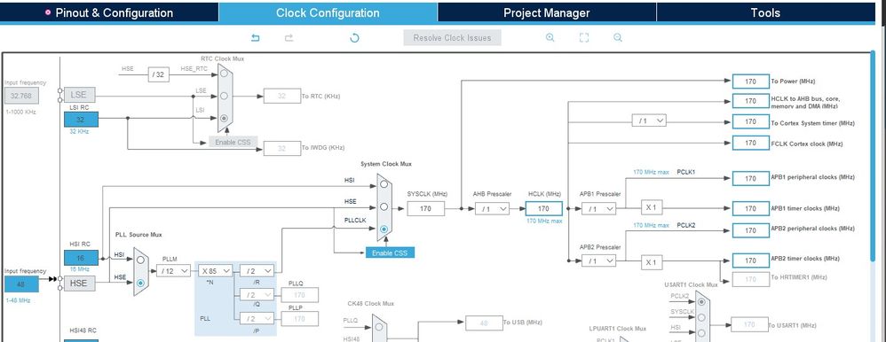

How did the SPI2 get the clock to operate in Clock Configuration?
2023-04-10 7:44 AM - edited 2023-11-20 8:58 AM
Set the HCLK 1to 170 MHz. Use the Cube Clock configuration tool.
As below. (note: this config is likely not optimal, only as example)
Then the SPI baudrate will be as on your screenshot.
