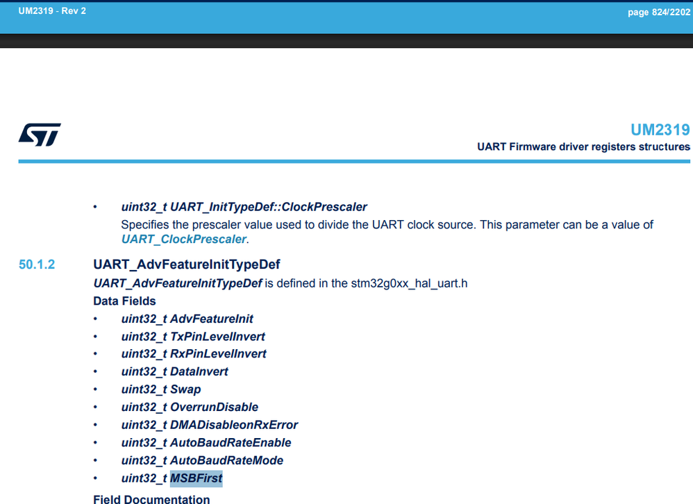

PS:
maybe this is it?

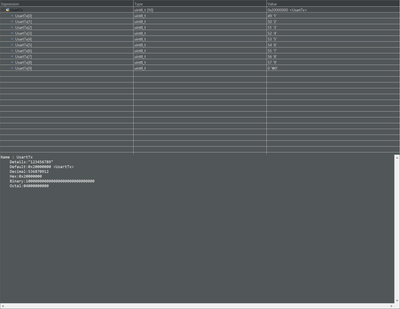

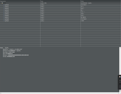

2025-04-23 5:47 PM
I've enabled MSB_FIRST BIT since the initialization of USART, but the output results remain unchanged. (It still seems to be operating as LSB first.)
Is there any way I can try it now?
Below are the buffers I sent to USART(UsartTx) and the buffers I received with SPI(SpiRx). In CUBE MX, I changed SPI to MSB First.
Thank you.

2025-04-26 12:34 PM - edited 2025-04-26 12:37 PM
From the RM, about the MSBFIRST: "This bitfield can only be written when the USART is disabled (UE=0)."
So don't set this bit after init(), rather set the AdvFeatureInit struct members as usual.
