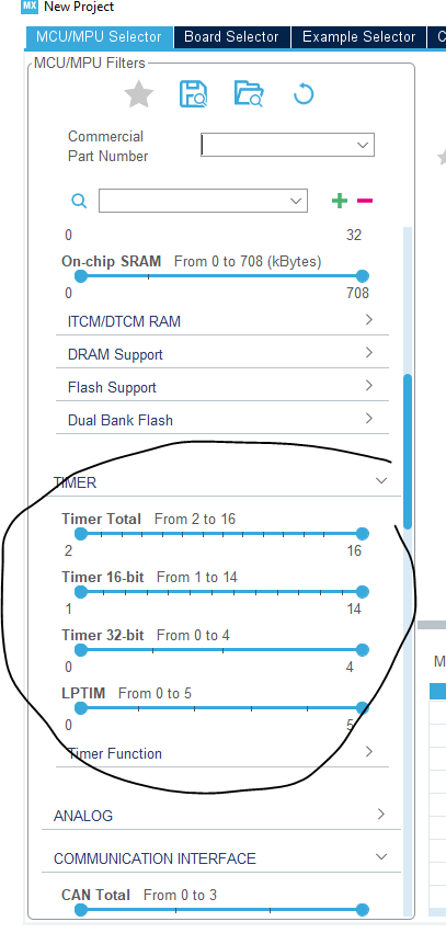

2023-02-16 12:04 AM
Search fot number of TIMers,
So it would boil down to series F1 F4 and F7

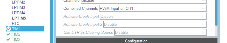

Javier,
Yes, I'm using the "Combined Channels" feature which allows the channel 1 input capture to measure the signal period and channel 2 to measure the pulse width (on time). This has worked well in combination with DMA.
I will look into the ADC suggestion :)
STM32F7 value line is the best match so far, but it would be useful if the search function in STM32CubeMX or the ST website allowed filtering by which timers support PWM input capture
Depending on particularities of input signal, you should be able to get away without the timer reset, purely from input capture on the CH1/CH2 and CH3/CH4 pairs, doubling the capability of the "usual" 4-channel timers. If edges are sufficiently far apart, a single channel should suffice per signal, allowing you to use almost any STM32 with enough pins.
