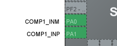

For COMP1 on STM32G0 here are the pin assignments from the reference manual
I want PA1 and so I've chosen that in the STM32CubeMX
However, the generated code sets
and the value of InputPlus is

Which apparently maps to PB2 which is wrong!
On the other hand, COMP2 I have chosen PB6 and its getting
COMP2 seems to be right but COMP1 is not.
I have reconfirmed this after forgetting about it and spending hours debugging why my COMP was triggering instantly. Definitely a bug.
