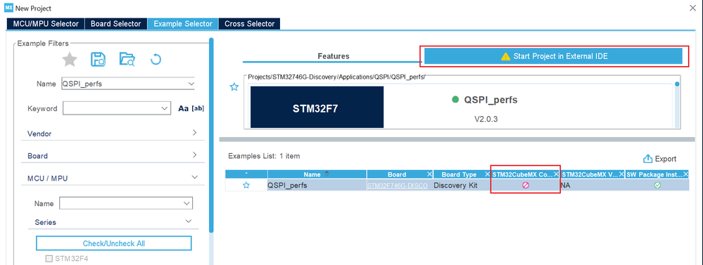

The issue doesn't seem very clear to me, hence I'll share with you my comprehension to avoid any misunderstanding. So, you're trying to start your project from a selected example using the Example selector feature through STM32CubeMX tool. Please correct me if I misunderstood.
Some of the examples are not STM32CubeMX compatible (which is the case of QSPI_perfs, STemWin and TouchGFX examples). When selecting one those examples, you can only start your project in an external IDE:
Clicking the Start project in External IDE button, STM32CubeMX allows you to open the newly created project either with:

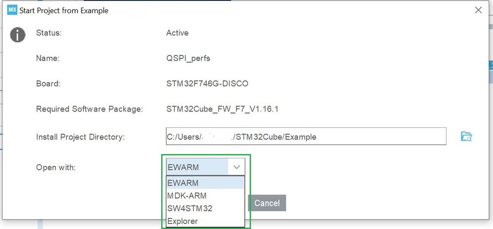

>When CubeMX asks the IDE to export to CubeIDE is not listed. I installed CubeIDE 1.6.0 after CubeMX.
The options for Export Project or Start Project in External IDE.
EWARM
MDK-ARM
SW4STM32
Explorer

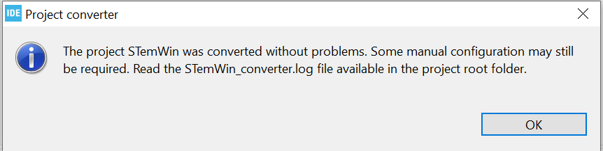

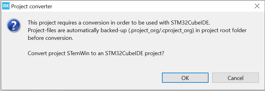

That's true CubeIDE is not listed within the available IDE list but if you select SW4STM32, STM32CubeIDE workspace will be launched automatically and a dialog box asking to confirm the migration of the project from System Workbench to STM32CubeIDE will be displayed:
Further on, another dialog box informs that the import was successful and that some manual configuration may be required:
Trying with the STemWin example, everything works right and the build finished without problems.
