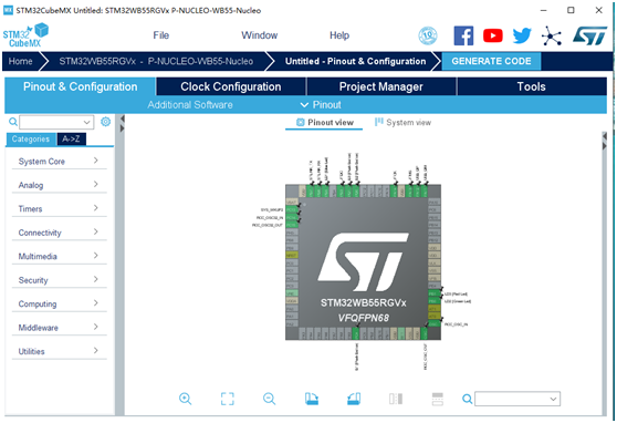

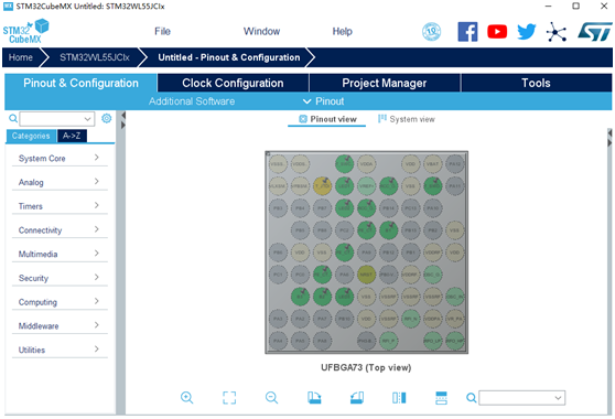

I have use stm32CubeMx for code generate.
In a new version I cannot find the generate code button.
old version has the generate code button .
but the new one is none

ver5.6.1 can not use the stm32WL, I used the STM32CubeMX 6.99.1-D37 version ,

As disccued with @Community member , the official CubeMX version will be available to download w28 from site (which supports the WL)

@Community member WL will not be supported in 6.0.0, it will be for 6.1.0.
