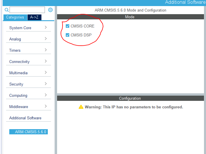

I had the same issue with CubeMX 5.5.5, one has to check on this screen the CMSIS packages:
Then arm_math.h will appear:

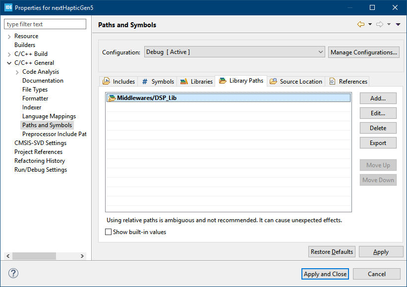

Copy both arm_cortexM4lf_math.lib and libarm_cortexM4lf_math.a to a manually created subfolder:
Set the Path for libraries then:

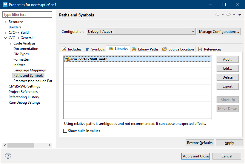

And specify the library to be used - without extension!!!!:
Don't know, why I have to copy both arm_cortexM4lf_math.lib and libarm_cortexM4lf_math.a, took a long time to figure out, which type of libray is the right (I have a STM32F4 - it looks like it's little endian, with FPU). Don't know why I have to specify the library name without an extions. But it seems to work now.

Correction:
It is sufficient to copy only libarm_cortexM4lf_math.a.
Without extension and without the prefix 'lib', i.e. the file namend libarm_cortexM4lf_math.a has to be specified as libarm_cortexM4lf_math.a in the Path and Symbols dialog.

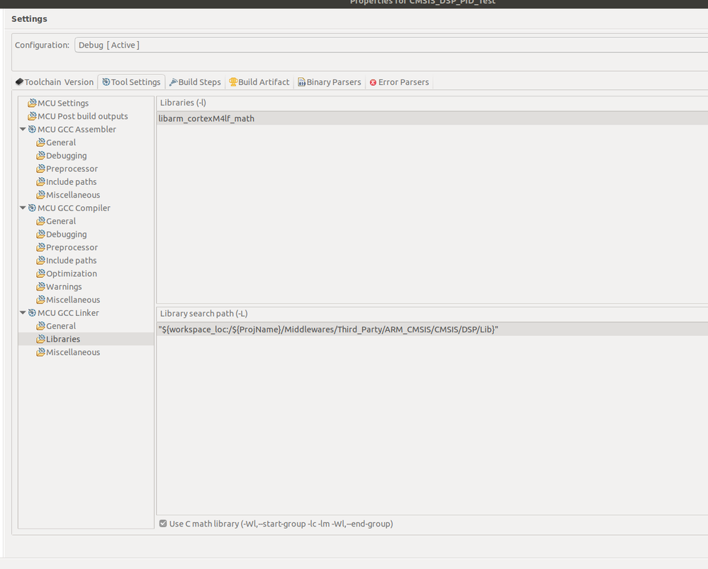

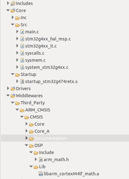

I copied the libarm_cortexM4lf_math.a into a Lib folder inside my project directory.
And specified the library in the linker settings as shown in the picture below.
But I still get an error message saying that, the library was not found.
08:24:46 **** Incremental Build of configuration Debug for project CMSIS_DSP_PID_Test ****
make -j12 all
arm-none-eabi-gcc -o "CMSIS_DSP_PID_Test.elf" @"objects.list" -llibarm_cortexM4lf_math -mcpu=cortex-m4 -T"/home/sandhan/Projects/STM32CubeIDE/workspace_1.3.0/[Nucleo-64 STM32G474RE] Projects/CMSIS_DSP_PID_Test/STM32G474RETX_FLASH.ld" --specs=nosys.specs -Wl,-Map="CMSIS_DSP_PID_Test.map" -Wl,--gc-sections -static -L"/home/sandhan/Projects/STM32CubeIDE/workspace_1.3.0/[Nucleo-64 STM32G474RE] Projects/CMSIS_DSP_PID_Test/Middlewares/Third_Party/ARM_CMSIS/CMSIS/DSP/Lib" --specs=nano.specs -mfpu=fpv4-sp-d16 -mfloat-abi=hard -mthumb -Wl,--start-group -lc -lm -Wl,--end-group
/opt/st/stm32cubeide_1.3.0/plugins/com.st.stm32cube.ide.mcu.externaltools.gnu-tools-for-stm32.7-2018-q2-update.linux64_1.0.0.201904181610/tools/bin/../lib/gcc/arm-none-eabi/7.3.1/../../../../arm-none-eabi/bin/ld: cannot find -llibarm_cortexM4lf_math
collect2: error: ld returned 1 exit status
make: *** [makefile:44: CMSIS_DSP_PID_Test.elf] Error 1
"make -j12 all" terminated with exit code 2. Build might be incomplete.
08:24:47 Build Failed. 1 errors, 0 warnings. (took 470ms)2020-07-21 6:56 AM
Answer for me was given in this link. gnu linker adds the lib prefix. So without the lib starting in the name it worked for mer
