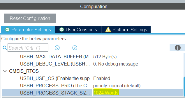

So it seems the hard fault was due to stack overflow, I increase the default stack size for the USB task from default 128 to 1024. But this is found by hunch only, I could not relate systematically from the the failure to stack overflow.
If this is the case, I wonder why STM32CubeMX set default USB Middleware task size as 128? Anyway I can ping the person in charge?

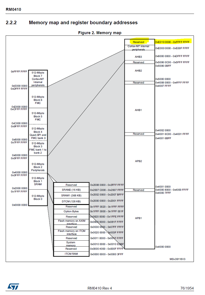

As additional point, I take a look the MCU Reference, on the memory map, address 0xfffffffd belongs to 'Reserved' area, so why would the code try to access it? This far, I have not event put any of my code, still generated code.

Seems more like a double fault
The 0xFFFFFFFD is a magic LR value to unwind an interrupt/exception, think of it as a call-gate which pops the MCU context from the appropriate stack.
A disassembly isn't going to work, you'd do better inspecting the stack in the Hard Fault Handler.
Look at what prvPortStartFinishTask() is doing at line 261 in port.c

The stack size was by far too small (seems just the configMINIMAL_STACK_SIZE was used, which covers the bare minimum FreeRTOS itself requires).
However, when using FreeRTOS I’d also strongly recommend to define configASSERT and also enable stack overflow checking for development/debugging. There is also a good FAQ and worth reading along with a dedicated doc regarding hardfaults.
