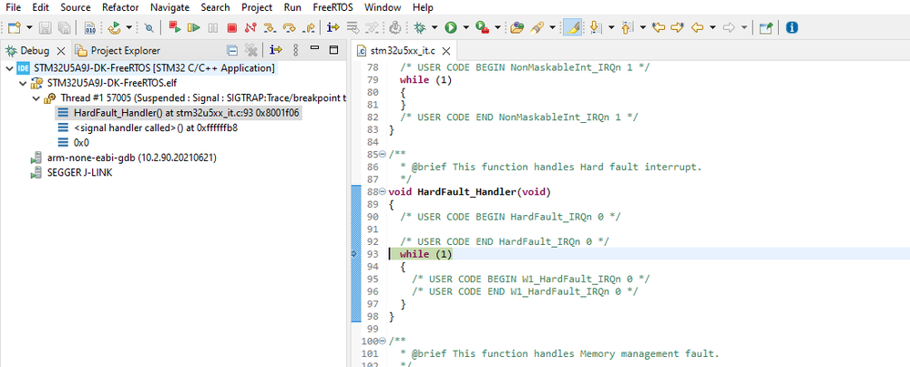

In both cases, sometimes i was able to bring the debugger up, when pressing the Reset button on the Dev Kit. I would suggest, that the Reset of the MCU is not correctly handled.
On the J-Link i always have to press the Reset Button so it might be a configuration issue or Bug of Reset/Startup behavior.

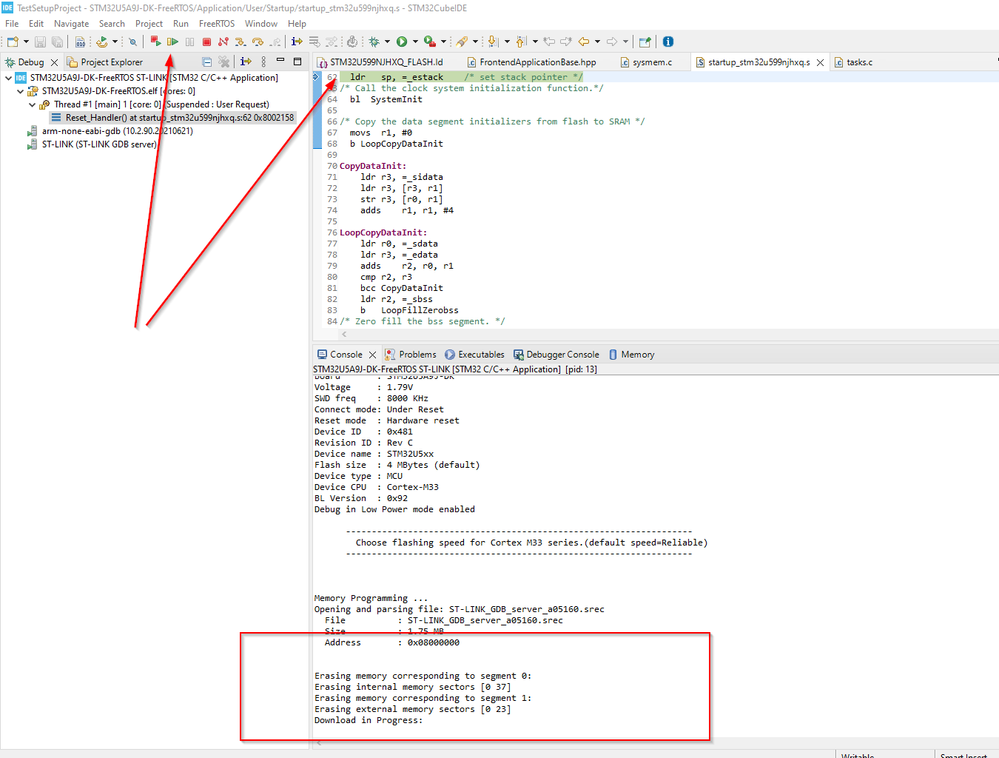

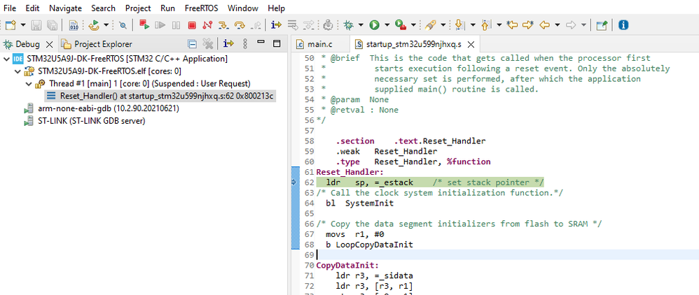

I just found out, that the CubeIDE starts the Debug perspective where it look's like it is in break state somewhere in the startup file. But in the Console, i see that the ST-LINK is still programming the memory:
So i guess, this is a bug of the CubeIDE which should wait for Flash programming before starting the Debugging perspective.
Still sometimes i have to reset the board manually by pressing the reset button first.
