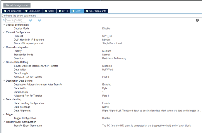

I am using SPI with DMA as shown in the screenshot. DMA is using Data Handling to truncate data from SPI's 16bit buffer into 8 bit values.
The following part of the code errors out. Commenting this code out makes my application work, but every time I change things in CubeMX it is rewriten. Why does this check even exist?

2024-03-29 9:37 AM
Why'd you read the peripheral as 16-bit wide, and try and push that out as 8-bit?
The peripheral should be able to decode the width of the access.
Is the SPI in 16-bit mode? If not just be consistent across the board.
2024-03-29 9:55 AM
I am using this SPI to talk to LIS3DHTR accelerometer. I transmit using
HAL_SPI_TransmitReceive_DMA(&hspi1, (uint8_t*) ACC_READ_ALL_DMA,
(uint8_t*) (acc_value+acc_value_cnt), 32*3);
