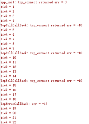

The typical print of the execution process:
The ticks are the elapsetime in second since the application starts running.

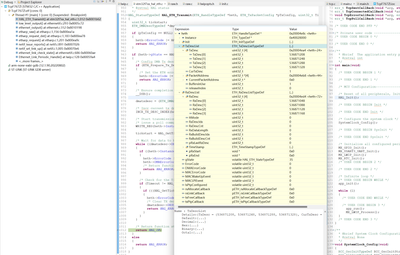

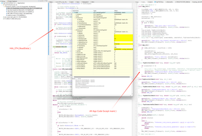

We successfully ran an LWIP+RTOS http server example on this Nucleo board 2 weeks ago, so the board itself shouldn't have any problem. Today, I checked the code for initialization and that in while(1) loop in main.c against two Cube examples targeted on different boards, I didn't see any difference. I did a reset on LWIP configuration, then disabled DHCP, chose Lan8742 in Platform Settings, enabled LWIP_RAW APIs, and changed nothing else, I got the same result: the server running in a socket tool did not show any new connection, and the F767's Tcp connection was aborted after 19 seconds. I created 2 breakpoints, one at the end of HAL_ETH_Transmit( ), the other at the end of HAL_ETH_ReadData( ), do the following two figures show the SYN packet was successfully sent out and 60 bytes were received?
